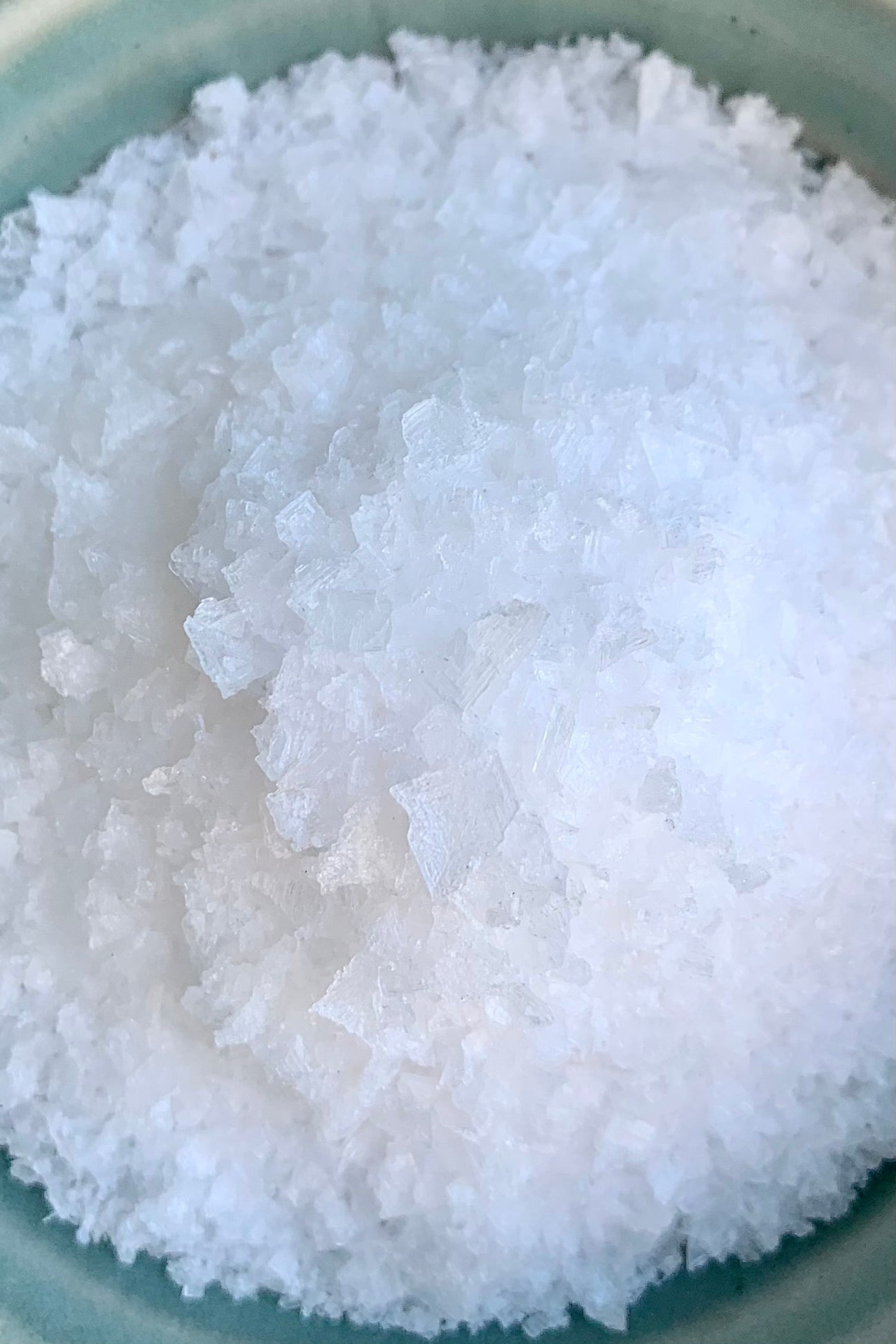

Do you have a real picture of what you aim for ? It’s always better to have a reference.
Best
That makes sense, of course.
It doesn’t have to be a close-up like this, but it should have a sharp-edged, critical structure.

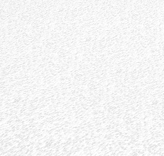

This is the way I tried it, but it’s only moderately good
I would try to start with a cellular node and play with the shapes sliders.
Maybe with two nodes and a color composite to get different sizes, or play with levels and level scale
